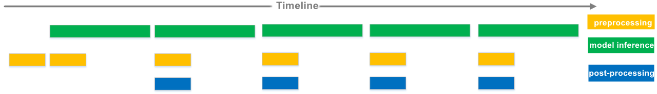

In general, an application can be divided into 3 stages: pre-processing, model inference, and post-processing output.
A simplified workflow is as follows:
app_optimization_1
After making full use of the workflow management to achieve the parallel execution of different task stages, the ideal task processing workflow can be as follows:
app_optimization_2
